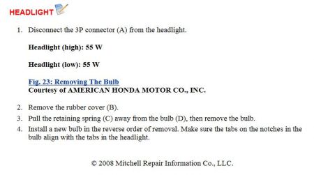

How do you replace the low beam head lojghts?
Wednesday, July 1st, 2009 AT 12:51 PM
KHLOW2008
MECHANIC
41,815 POSTS
Hi jackded,
Here are the procedures.
