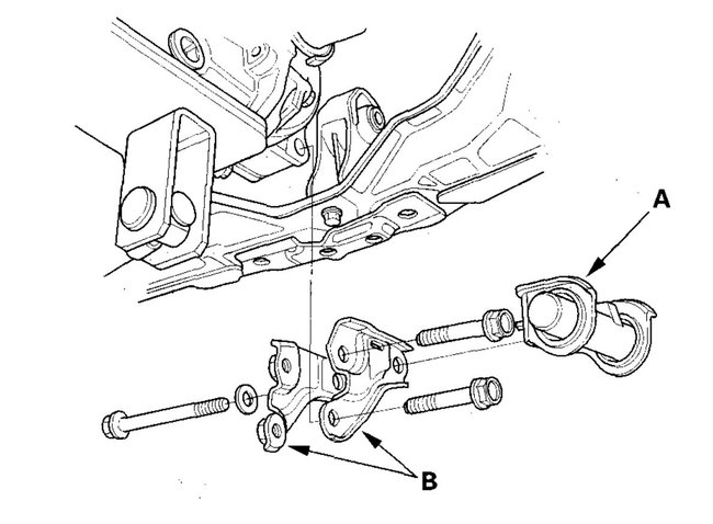

How is the real differential damper removed from my vehicle
Can it be removed while on the ground? Has anyone done this job? I just don’t want to bring my car to the dealer shop. Please show me how to remove it and install new one.

The diagram should be self explanatory. You would have to jack up the vehicle to do so.
