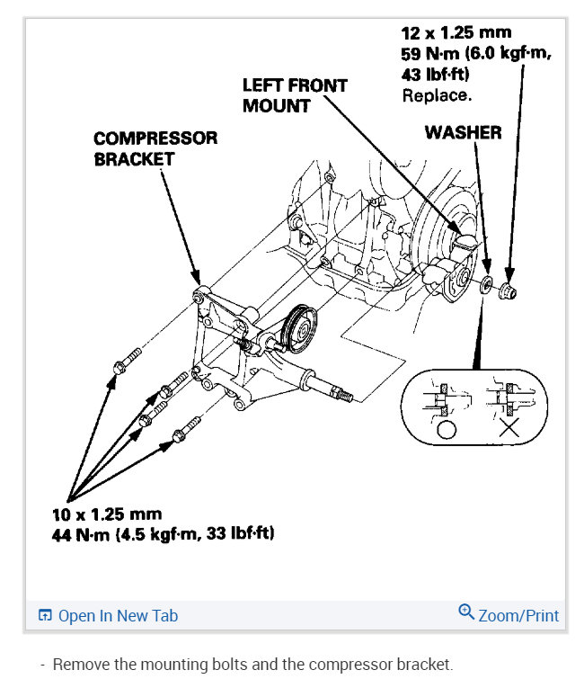

The Ac stops working and the condenser fan fuse keeps getting blown. I noticed that at cold engine temp the ac will work with a new fuse but until engine temp goes up then the fuse fails. While at high temp , putting a new condenser fan fuse will blow immediately once ac is turned on. Could it be a bad clutch relay? Checked blower fan and it spins freely. No obstruction.

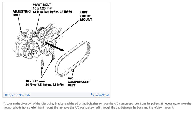

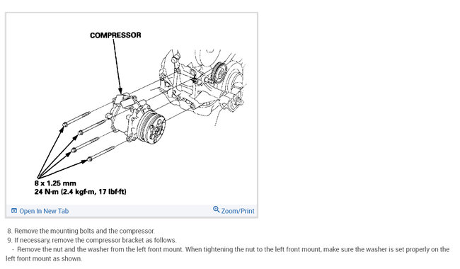

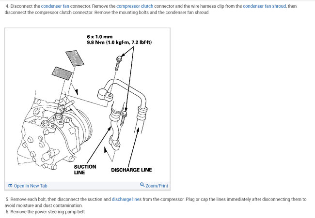

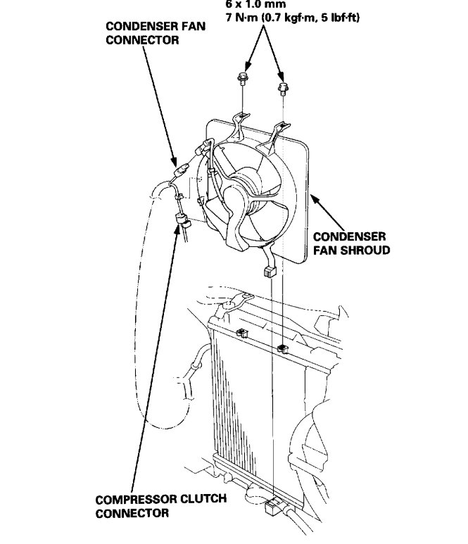

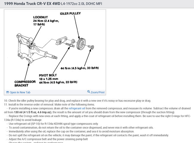

It sound like the compressor clutch has shorted out but to be sure replace the fuse and disconnect the compressor to see if the fuse blows once the AC is turned on. If not the compressor needs to be replaced. Here is a guide to help walk you through the steps with guides below to show you on your car:
https://www.2carpros.com/articles/replace-air-conditioner-compressor

What happens is the clutch coil shorts out due to age and pops the fuse 9 times out of 10. If the relays look the same you should be able to swap them. Let me know please.

Hello. I swapped the relays but did not really help other than ruling it out as the fault. It turned out to be something over the current capability of someone new like me. Got help on this one and as suspected, it came up that the magnetic compressor clutch is causing the fuse to short out. When getting it replaced, a bigger issue was found. The shaft (not sure if it's the correct name for it) where the magnetic clutch connects to the compressor is already faulty. It is loose and has a play to it. Was told replacing the clutch alone will just result on it failing again so I ended getting the whole compressor and clutch replaced.
Thanks for the help in guiding me to the right direction. though it turned out to be a costlier repair than what I had anticipated and hoped for.

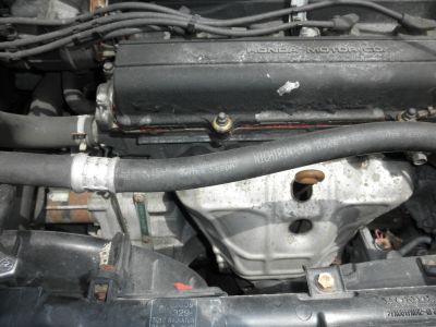

GORILLACOMPANY
I tried to locate the A/C compressor, but I don't know enough figure out what it is. I attached the picture, everything red appears to be new within the last few days.
https://images.2carpros.com/forum/automotive_pictures/531721_P5270024_1.jpg
The red substance is all around the crease, and seems to have dripped down on other engine parts.
Apr 18, 2019 at 10:32 AM (Merged)
KHLOW2008
  • CAR REPAIR CONTRIBUTOR
  • 41,814 POSTS
That is the valve cover and the red substances seems to be sealants. I don't see how sealants could be dripping.
Under normal circumstances, sealants are not used as the valve cover gasket is a rubberised seal and is compressed to prevent leakages.
The compressor is the component at lowest point of engine at front part where it has a belt going over it.
When A/C is turned ON, the outer part should click and attache itself to work.
