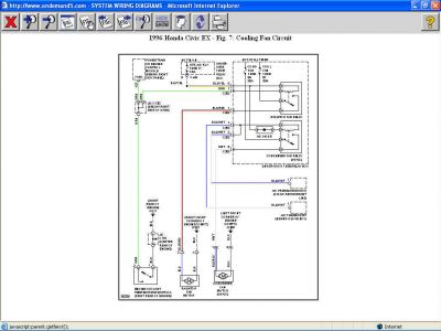

My Honda Civic overheats. I've determined that the fan is not coming on when the car reaches a certain temperature. At first, I thought it was the fan sensor. I replaced it and nothing, fan is still not working. What do you guys thing it might be? A fuse maybe?

If you replaced the sensor, I would think you would jump right on looking at the fuses first. After that, unplug the fan and hook two wires to it and connect it to the battery. If it runs, plan A, if not replace it. I think there is another sensor in the circuit.

Here is a circuit diagram. Check the relay and you could do this by switching the condensor relay and the cooling relay.
