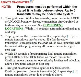

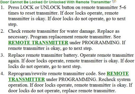

Need to reprogram the remotes.
https://images.2carpros.com/forum/automotive_pictures/55316_00accordremote_1.jpg
If that doesn't work,
https://images.2carpros.com/forum/automotive_pictures/55316_00accordremote2_1.jpg

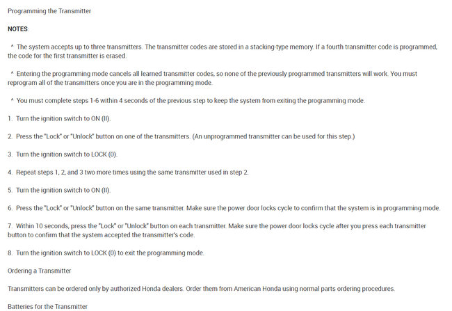

HONDA TECH 1818
  • CAR REPAIR CONTRIBUTOR
  • 536 POSTS
You can try to reprogram the keyless remote.
* Turn the ignition switch to ON, within 1-4 seconds press the keyless remote lock or unlock button.
* Turn the ignition switch to OFF.
* Turn the ignition switch to ON again and within 1-4 seconds press the keyless remote lock or unlock button.
* Repeat the top procedure for one more time.
Oct 3, 2020 at 10:04 AM (Merged)
PNRETS
I tried what you said and it works one time. Meaning,at the 4th on/off the locks will open or close but when I get out of the car it doesn't work. I tried it several times. always on the 4th time.
HONDA TECH 1818
  • 536 POSTS
When you hear the door lock cycles during programing just press the keyless remote lock or unlock button one more time and then remove the key.
PNRETS
YOU ARE AWESOME. Thank you, my arthritic fingers thank you. Now a rhetorical question. WHY did my honda dealer want to charge me $20.00 for this? you don't have to answer.
