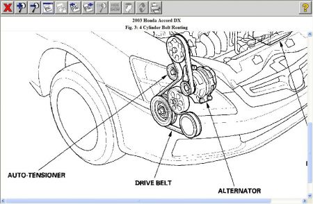

How do I remove and replace the drive belt?

Hi laurbar24,
The auto tensioner has to be twisted clockwise to release the tension on the belting to remove it and to install new belt.
