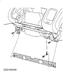

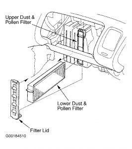

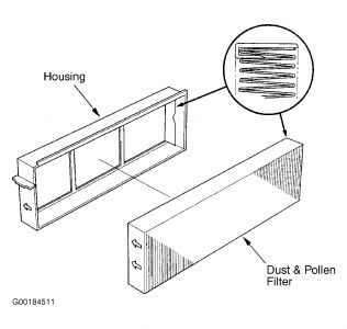

What do I remove in order to change the cabin filter?
Do you have an illustration?
Jun 29, 2009 at 12:52 PM
BLUELIGHTNIN6
  • CAR REPAIR CONTRIBUTOR
  • 16,542 POSTS
Remove the glove box. Remove the bolt, screws and the glove box frame. Remove the filter lid from the evaporator, then pull out the lower dust and pollen filter and the upper dust and pollen filter in that order. Remove the filter from the housing and replace it. Install the filter in the reverse order of removal. Ensure the arrow marks on edge of filter face in the direction of the air flow. Make sure that there is no air leaking out of the evaporator.
