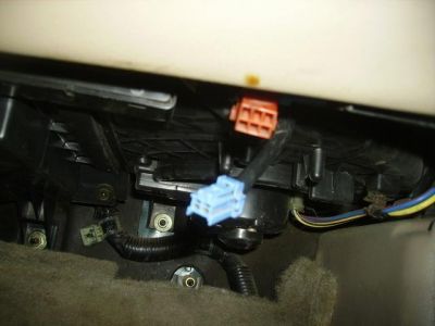

and another thing, I noticed that there is a blue cord coming from under my glove compartment it looks like and ethernet cord? what is that?

Hi am06tz,
What does the cord look like? If it is 2 or 3 pin, then it could be for the Service Check Connector or Data Link Connector

https://images.2carpros.com/forum/automotive_pictures/260432_cord_1.jpg
hey this is not my car but, this is exactly what it looks like (the blue cord) I hope you don't mind my Q's i just want to know beforehand sometimes when I start my car, there is a slight rumble...nothing outstanding but...I heard this could be a cylinder "misfire" or i could just need new spark plugs??

Hi am06tz,
No problem, anybody can ask any questions and we at 2carpros will try to answer as best as we can.
Looks like the Service Check connector but for 97 models it should be OBD II equipped.
Some connectors are not used as they are for some other accessories which this vehicle is not equipped with.
If there is any misfiring, you would most likely feel some vibrations.
