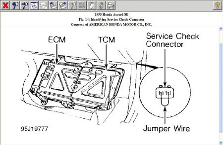

Hi james_08, When the D3 light blinks, an error has been detected in the system and you need toretrieve the trouble code to understand what is wrong. Use a jumper across the SCS and turn ignition switch ON. Count the blinking of the D3 indicator. Delayed flash = 10 while short quick blinks are 1. A prolonged pause would pause after each code and the cycle would repeat after all trouble codes have been shown.
https://images.2carpros.com/forum/automotive_pictures/192750_SCS93Accord_12.jpg
