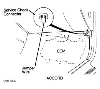

How do I do a self diagnostic test without the machines and where do I find the wires for that

Locate test connector see diagram
Jumper wire between terminals, key on MIL will flash possible 43 codes so Flash, Flash pause Flash=21
Post codes
