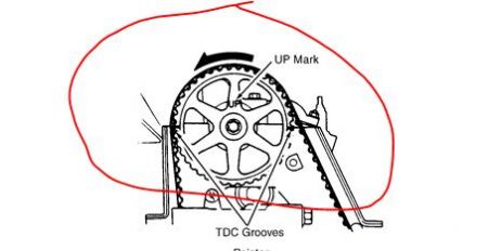

I know this may be a novice question but where is the top timing belt cover on the 92 accord?
Jun 7, 2010 at 7:42 PM
MHPAUTOS
  • CAR REPAIR CONTRIBUTOR
  • 31,937 POSTS
The top timing cover fits over the cam gear.
