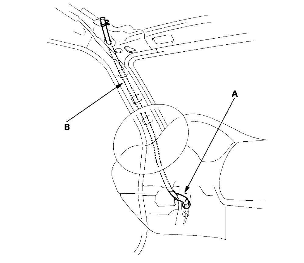

The driver side floor is wet. i dont know where it comes from but it isolated to an area that is away from the pedals and basically in the portion of the floor directly in front of the seat. if i leave the mat on the water collects on the bottom of the mat and fogs up the car. the leak must be minor because its not that wet but more moist and damp.

The leak could be coming from the moon roof drain hose, remove the driver's side kick panel (Plastic cover by your left foot, under dash) to inspect the drain hose and the drain valve connection. The drain hose should be connected to the drain valve.
Attached below is a drawing of where the drain goes
