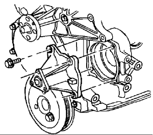

How do I replace the water pump?
Mar 19, 2010 at 2:54 PM
  • CAR REPAIR CONTRIBUTOR
  • 75,992 POSTS
REMOVAL PROCEDURE
https://images.2carpros.com/forum/automotive_pictures/12900_w1_1.gif
Remove the coolant from the radiator. Remove the drive belt. Remove upper fan shroud. Remove the fan. Remove the fan clutch assembly. Remove the water pump drive pulley.

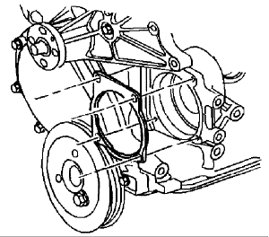

https://images.2carpros.com/forum/automotive_pictures/12900_w2_1.gif
Remove the water pump attaching nuts and bolts. Remove the water pump.

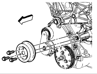

https://images.2carpros.com/forum/automotive_pictures/12900_w3_1.gif
Remove the water pump gasket. Inspect, to make sure all parts are free of burs or other imperfections, replace as necessary. Clean all of the mating surfaces. https://www.2carpros.com/kpages/auto_repair_manuals_alldata.htm
