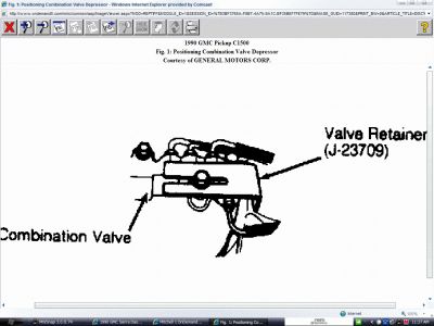

If all these where checked, it's possible the proportioning valve is stuck off center, jack up the rear of the truck press brake pedal, do the rear brakes hold? The other thing to do is grab an assistant to help bleed the front calipers, you will need to press and hold the button on the front of the prop valve while you bleed it. Sorry about the confusion!
https://www.2carpros.com/forum/automotive_pictures/62217_Combi_valve_1.jpg

ZIPDADDY
  • 6 POSTS
Wow! Thanks for the quick reply. I was just heading outside to bleed the prop. Valve when I got your reply. I'll let you know how it works out.
