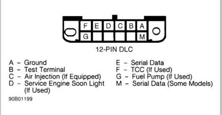

Welcome to the forum, thanks for the donation. If it refuses to start right away, have a helper crank it, while you check for spark at the plugs, if that checks out, use a gage and check fuel pressure. Also, check for codes,You use a jumper wire between the A & B terminals at the datalink connector. The connector in the picture is generic. Your looking for two digit codes.

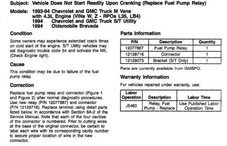

I'm not positive about your engine size. I found this service bulletin. I can't be sure it will fix your problem. I'd have to check the actual voltage reading at the fuel pump connector and relay.
