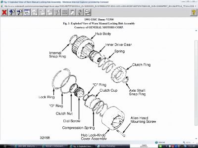

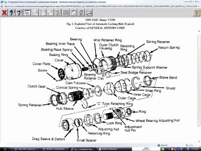

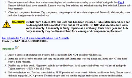

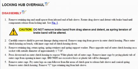

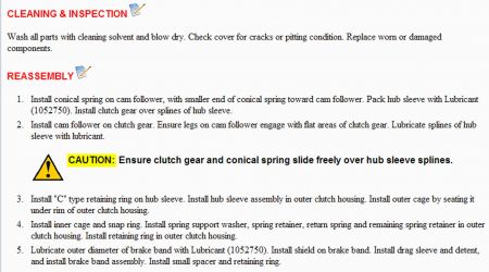

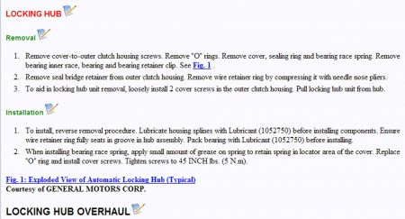

ihave have a 1991 gmc s15 jimmy and my four wheel drive wont work.. i shift it into four high my transfer case kicks in but my front wheels wont pull. thanks!

Sounds like you might have to check the hubs...
