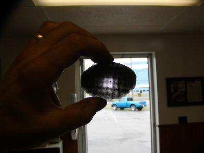

It would be good to pull the codes from the computer. It sounds like a converter is plugged and it can be intermittant. Sometimes if you rap on the bottom of it you can hear it rattle if it is broken internally. It may be a piece flipping sideways preventing flow.
https://images.2carpros.com/forum/automotive_pictures/30961_P8200023_2.jpg
https://images.2carpros.com/forum/automotive_pictures/30961_P8200022_2.jpg
It will give off a distinct smell and give the power loss. Sometimes when the problem is happening you can see the converter glowing from the excess heat. The way to test it is to drop the exhaust in front at the manifold, wire it so it doesn't drag and drive it.
