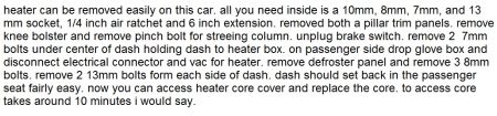

I need to know the steps in replacing a heater core.

http://www.2carpros.com/forum/automotive_pictures/261618_Noname_2627.jpg

This is a VERY involved job that requires removing the entire dash and then the entire HVAC system and disassemble it. It's not possible to post all that. I would suggest getting as service manual for that vehicle but unless you have done something like this before, this is not the job to learn on. You will also need a refrigerant recovery and recharge station.
