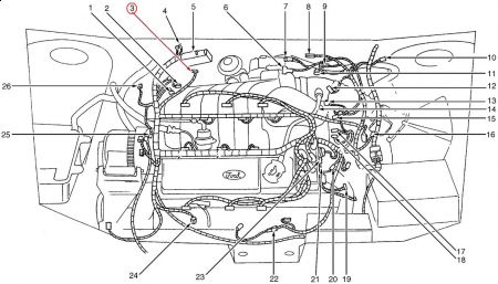

Try checking your VSS Vehicle Speed Sensor. It is responsible for speedo and transmission shifting operations. Located at rear center of engine compartment, mounted on the transaxle.

Just to update -- It was in fact the VSS that was causing my problems. It was a very quick and easy replacement (once the part was located).The car is moving much better now with all problems functioning the way they should. Thanks for the help!
