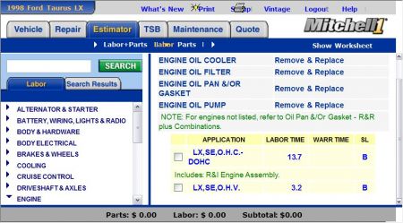

Help please.....how long does it take to change the oil pump via a mechanic's guide? Does the exhaust have to be removed from the exhaust manifold to remove the oil pan to do this.
I am verrrry ill that I may have ruined the engine as I didn't know the oil light meant something serious and I drove it to work. The engine has not seized yet. We cant afford another car or car payment...My husband will try to do it himself if he has detailed help.....but we do have a friend who said he'd charge us based on how long the "book" says it takes....please help
Dec 23, 2007 at 8:46 PM
  • CAR REPAIR CONTRIBUTOR
  • 75,992 POSTS
See labor guide below
https://images.2carpros.com/forum/automotive_pictures/12900_RR_oil_pump_1.jpg

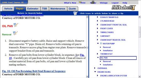

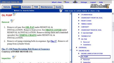

Inbox :: Message From: angelshutters To: rasmataz Posted: Sun Dec 23, 2007 10:51 pm Subject: Ford Taurus Thank you for that info...how much would something like this usually run? I believe ours is the one for the 3.2 hours...its a standard Taurus...sedan...3.0 engine Is this something my husband could do...or he'd need a garage to do it in? His biggest issue is how to get to the oil pan...he wasnt sure about removing the exhaust from the exhaust manifold to get to it.. Could range between $70-$125 an hour plus oil pump and gasket/oil/filter depending on your location. See below
https://images.2carpros.com/forum/automotive_pictures/12900_oil_pump_3.jpg
https://images.2carpros.com/forum/automotive_pictures/12900_oil_pan_1.jpg
