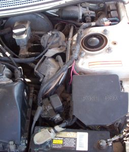

I am sorry, but I am just not seeing it, or what I think it would look like long view pix attached from battery to master cylinder.

https://images.2carpros.com/forum/automotive_pictures/469490_DriverStrutarea_2.jpg
Sorry didn't include picture :)

Look under thing with hoses attached module is small blck attached to strut tower with two screws

I can see nothing electrical clear down to the bottom of the fender except the web of mounting brackets for vacuum stuff unless it is under the fuse block or battery ahead of the strut. I am still looking.
Jan 25, 2010 at 11:53 AM
DSHROADS
  • 18 POSTS
Finally see the heat sink -- that must be it and I have no earthly idea how I will get to it as I cannot even get my hand between it and the engine from the top or the bottom. Thanks will keep u posted

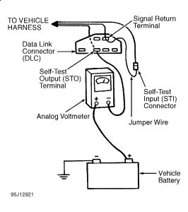

Check for codes will need an Analog Volt Meter connect as in diagram
https://images.2carpros.com/forum/automotive_pictures/198357_Graphic_334.jpg
codes are shown by meter arm swing key on engine off say arm swiings pause swings,swings pause swings, swings that is 122. post codes

Off to buy an analog meter, of course my two analog ones are not here and my Fluke is digital. My leads are all six in one row, so how do I know which is the self test?

STI on fender next to battery it will look like the figure

OH, I thought that was the connector to the ignition module, sorry.

If I did it right DC Voltage range, key in ON position but not cranking, nothing but straight 12vDC measured.

It does not show well in diagram but did you run jumper wire from top row far right term to the single wire?
Jan 25, 2010 at 4:09 PM
DSHROADS
  • 18 POSTS
Now that you explain it, it does show well, no, I did not.
A jumper wire from single connector to top right (signal return) and meter negative connected to bottom second from left (Self-Test Output). Positive of meter to positive battery terminal. Used 250 VDC scale because I was not sure what voltage was generated, but needle was rock solid.

I presumed the test involves inserting the meter to an active circuit. Is the battery still to be connected to the rest of the car when I try to read the codes?

Yes battery hooked up place meter on low scale only battery voltage will be present.

250vdc scale - shows 12 volts but no visible needle movement when ignition switch is turned on.

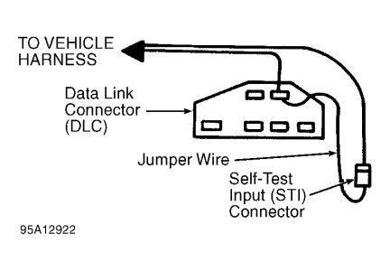

O.K. try this hook up jumper wire from STI pigtail to DLC see figure Key on watch MIL on dash if it flashes codes

what is "MIL on dash"?

NOTE: I had battery disconnected for a bit yesterday and have pulled and reseated every fuse in the vehicle.
Jumper as you note STI to upper right (as I am looking in the end) of the connector.
Turn key to on and check engine light flashes what seems to be 3-3---1--3-3. Dash represents relative length of the pause between numbers.
It is hard to tell if there is a first single flash because all the lights come on and off in the self-test, so it may be starting with a 1-. I cannot tell.
Did this three times with the same result.

Unfortunatly 33 or 133 are not vialbe codes. So lets go back to basics at coil check Black/Pink wire for 12v= with key on. Also put test light on Yellow/Blue crank flash or steady?

BTW I just duplicated those codes, they may not be documented, but they are certainly "real."
