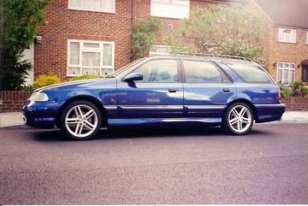

Hi it is a 1993 ford granada estate rear wheel drive uk specifications 2.0l twin cam 4 cylinder injection automatic scorpio model i hope this will help you to find the correct diagrams which will hopefully help us solve the problems thank you very much for your help many people know the car but iv found few who know how to solve the non responsive instrament panel (ignition)
https://www.2carpros.com/forum/automotive_pictures/390897_4136841_1.jpg
the picture shown is the same shape/model as ours hope this helps
