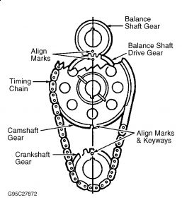

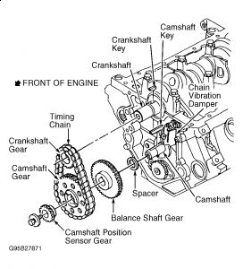

While removing nylon guides for chain the cam slipped off the chain how do I find correct alignment for it

This should help
