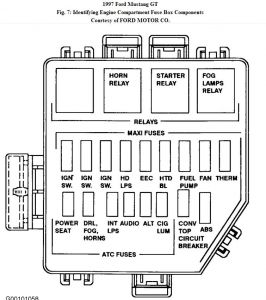

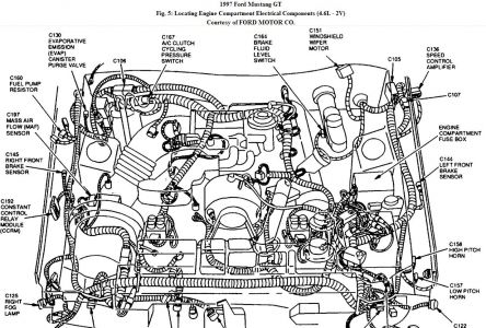

I have a 1997 mustang gt with 60000 recently my horn stoped working i checked the fuses they are fine i replaced the horn and still not working? also when ever i turn the heater on or ac air does not come out of the vents it only seems to come out from the vents that hit the windshield? what am i missing.

For the horn check the relay, and horn button, on is no good. For the a/c check for a broken vacuum supply line from the intake manifold to the reservoir tank, then into the car thru the firewall. Horn relay is in the under hood fuse box...

Need to know diagram on a fuse box and where in 97 mustang for interior and hood
