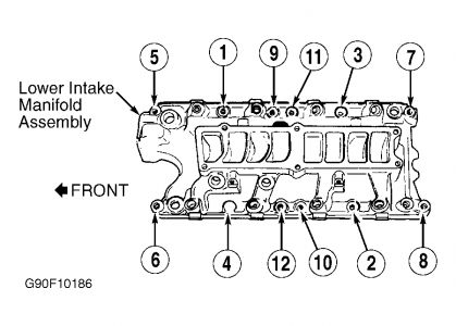

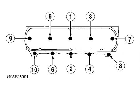

I need to know the torque specs for the main rod bolts and the head bolts

TORQUE SPECIFICATIONS Application.....................Ft. Lbs. (N.m) Camshaft Sprocket Bolt.......40-45 (55-61) Connecting Rod Cap Nut.....40-45 (55-61) Crankshaft Damper Bolt.......70-90 (95-122) Cylinder Head Bolt (1) Step 1...............................85 (115) Step 2,,,,,,,,,,,,,,,,,,,,,,,,,,,,,,,95 (129) Step 3..............................105-112 (143-151) Engine-To-Transmission Bolts....50-65 (68-88 Exhaust Manifold Bolt...............18-24 (24-32) Flexplate-To-Torque Converter Bolt..20-34 (28-45) Flywheel-To-Crankshaft Bolt..........75-85 (102-115) Front Engine Mounting Bolts/Nuts....50-70 (68-95) Intake Manifold Bolts & Stud Lower (2)........................... 23-25 (32-33) Upper...................................12-18 (17-24) Main Bearing Cap Bolt..............95-105 (129-142) Oil Pan-To-Cylinder Block Bolt 4 Each, 5/16" x 18...................12-18 (16-24) 18 Each, 1/4" x 20...................7-10 (9-14) Oil Pump Inlet Tube.,..................10-15 (14-20) Oil Pump-To-Cylinder Block Bolt......22-32 (30-43) Power Steering Pump Bracket Bolts,,,40-50 (55-68 Rear Mount-To-Crossmember Nut.......60-80 (81-108 Rocker Arm Fulcrum Bolt..................18-25 (24-34) Starter Bolt.................................15-20 (20-27) Timing Chain Cover Bolt...................15-21 (20-28 Valve Cover Bolt............................11-14 (16-20) Water Pump Bolts........................15-21 (20-28 INCH Lbs. (N.m) Camshaft Thrust Plate Bolt............108-144 (13-16) (1)Tighten in sequence. See Fig. 4 . (2)Tighten in sequence. See Fig. 3 .
https://images.2carpros.com/forum/automotive_pictures/266999_4_4.jpg
https://images.2carpros.com/forum/automotive_pictures/266999_3_6.jpg
