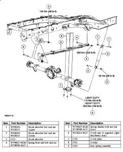

I am considering purchasing this truck but I am a little nervous about what could be causing the body lean. The rear pasenger side of the bed is about 2" higher off the tire than the rear driver side bed. Up front, the driver side fender is about 1" higher off the tire than the passenger side fender. The truck drives smooth and straight and I couldn't see any evidence of damage. I don't even mind the lean as ong as it doesn't lead to costly repairs down the road. Any ideas? Thanks.

What we see very common is the spring shackle corrode also check shocks ***************************************** need manual CHECK IT @ https://www.2carpros.com/kpages/auto_repair_manuals.htm
https://images.2carpros.com/forum/automotive_pictures/99387_Graphic1_321.jpg

You don't think it could be a bent frame?

Ive never seen it
what ive seen and very common is the shackle rust and brake off
causing the rear body to tilt
if you have any suspicions should have it check before you buy it
