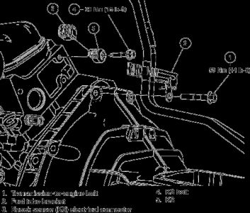

Here is the definition of a knock sensor that I got for you. Also, there is a picture of its location on the 6 cylender after it. Check it out and see if could be what you are dealing with or causing the problem for you. The operation of the Knock Sensor (KS) is to monitor preignition or "engine knocks" and send the signal to the PCM. The PCM responds by adjusting ignition timing until the "knocks" stop. The sensor works by generating a signal produced by the frequency of the knock as recorded by the piezoelectric ceramic disc inside the KS. The disc absorbs the shock waves from the knocks and exerts a pressure on the metal diaphragm inside the KS. This compresses the crystals inside the disc and the disc generates a voltage signal proportional to the frequency of the knocks ranging from zero to 1 volt. The KS is a tuned accelerometer on the engine which converts engine vibration to an electrical signal. The PCM uses this signal to determine the presence of engine knock and to retard spark timing.
https://images.2carpros.com/forum/automotive_pictures/249084_knock_2.jpg
#3 is the knock sensor in the picture. I hope this helps. Joe
