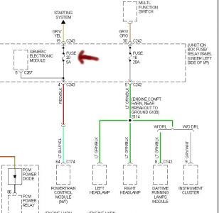

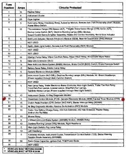

I needed to get the right diagrams..now I need time to look at them. These are the correct ones: Junction Box fuse 20 circuit
https://images.2carpros.com/forum/automotive_pictures/30961_f150juncfuse20a_1.jpg
https://images.2carpros.com/forum/automotive_pictures/30961_f150junctbox_1.jpg
https://images.2carpros.com/forum/automotive_pictures/30961_f150juncfuse20_1.jpg

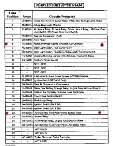

Power Distribution Box
https://images.2carpros.com/forum/automotive_pictures/30961_f150powerdis_1.jpg
Fuse 6
https://images.2carpros.com/forum/automotive_pictures/30961_f150pdfuse6a_1.jpg
https://images.2carpros.com/forum/automotive_pictures/30961_f150pdfuse6_1.jpg
Fuse 22
https://images.2carpros.com/forum/automotive_pictures/30961_f150powerdisfuse22a_1.jpg
https://images.2carpros.com/forum/automotive_pictures/30961_f150powerdisfuse22_1.jpg
https://images.2carpros.com/forum/automotive_pictures/30961_powerdisfuse22fuse1_1.jpg
https://images.2carpros.com/forum/automotive_pictures/30961_powerdisfuse22fuse1a_1.jpg

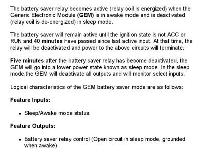

For the fuse #6, is this an aftermarket radio or original. Does the power to it remain on all the time, even if key is off? On fuse 22. the power runs to the junction box in the cab from the Power distribution box. I assume that fuse 1 on the junction box was pulled and there was no change on the draw, placing a problem between the two. I'm suspicious of this particular draw as it involves the GEM module which controls the Battery Saver feature. The draw on this circuit cannot be check for 45 minutes until the timer runs through. This may have been checked too early making it invalid.
https://images.2carpros.com/forum/automotive_pictures/30961_bs_1.jpg

I recently had an electrical issue with a 1997 F150. This particular truck has a 4.6 V8 with an automatic transmission (although this should apply regardless of the engine or trans.) With the engine shut off, all accessories turned off and key out of the ignition, the vehicle seemed to have a voltage draw which would cause the battery to die after a day or so of sitting without use. The battery was fairly new, so naturally we ruled it out. We performed the typical voltage draw test by disconnecting the positive battery cable and connecting a volt meter between the disconnected cable end and the battery terminal, which appeared to confirm a voltage draw was present. We then proceeded to the engine compartment main fuse block at the driver side fender well and removed one fuse at a time until the voltage draw disappeared. The 50 amp fuse in question powered the fuse block in the cab under the dash, so we reinstalled the 50 amp fuse and redirected our focus to the under dash fuse panel. After removing the fuse for the “Battery Saver” circuit, the voltage draw seemed to disappear. Since the battery saver circuit is designed to stay on for awhile after the ignition key is shut off (which would naturally cause a short term draw), we decided to go back to the beginning and check the battery. With the battery removed from the vehicle at full charge, we performed a load test. Although the battery seemed to do o.k. on the short term load test, it would very slowly lose voltage over an extended period of time and drop well below 12 volts when it was not connected to anything. Although the battery was only a couple of months old and didn’t initially seem to be the problem, it was in fact defective. We replaced the battery with another new one, and the problem was solved! Lesson learned: When you have an electrical issue, ALWAYS fully check the battery before suspecting other components. NEVER assume the battery is good unless you can prove it.
