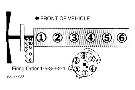

1995 Ford F150 6 cyl Two Wheel Drive Automatic? Miles
wat gap size do I need for the spark plugs
and wat cylinder fires first on the igition sequence
its a straight inline v6

Spark plug gap is .042 to .046.
Firing order:
Let me know if you have other questions and I hope this helps.
