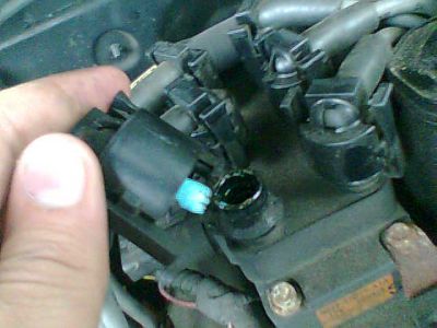

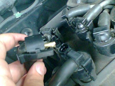

I was going through my spark wires checking them and making sure they were in place and didn't move, so I took one out and and the first one on the left side didn't have the metal contact for the pack, while the right side one has a metal contact, they were some sort of grease in there also.... Whats this about? They all have except one, I had a mechanic give me a tune up about 5 months ago.

https://images.2carpros.com/forum/automotive_pictures/82263_image003pz8_1.jpg
https://images.2carpros.com/forum/automotive_pictures/82263_image004ec2_1.jpg
See those pictures, why are those two different... I KNOW they all have to be the same. What did my mechanic do? The engine did start acting weird though. It feels much sluggish and eats a lot more gas.

The blue shielding inside is missing in one of the pictures. That is a locking mechanism for the spark plug boot onto the coil. I am not sure if that blue locking mechanism should be inside the coil or on the spark plug boots. You could always go up to a parts store and check out a set of wires and a coil and look at the difference between yours and a new one(my guess would be the blue locking mechanism needs to be inside the coil pack, so you might need to replace it). If it is causing a bad connection you will need to replace the one that blue cap is a part of. It appears that another difference in your pictures is a set of switched ignition wires on the ignition coil. I am assuming that is from the same coil pack. Recheck your firing order anyway. It should be on the emissions sticker in the engine bay or printed on the intake manifold.

That is a wiring order. Your firing order will be something like this - 1,3,7,2,6,5,8. (Give me the make, model, year and engine size of your car and I will let you know what it is). If all the wires are in the correct places as indicated on the coil pack then that is the best you can do really since the computer controls the firing order. You can loosen all of the connectors at the coil packs and one by one remove them and see if the engine shudders. Use insulated pliers or rubber gloves so you don't get shocked. If you come across one that makes no effect then that cylinder is a potential problem. You can get an OBD II code reader to do this for you as well. If the blue one does not have a metal contact that is your problem and you need to find out whether the contact is supposed to be a part of your coil or spark plug wire. My guess is the one missing the terminal connector is causing the engine to misfire. If you could pull back the rubber boot and take a good picture of that wire.
