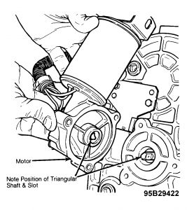

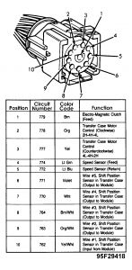

The 4 wheel drive has been working just fine until recently. The car is equipped with push button 4 wheel drive. I was having trouble with it engaging when I pushed the button on the dash for 4 wheel drive. I purchased new lock out hubs which allow me to manually lock the hubs in when I want 4 wheel drive. They work perfectly. Now all of a sudden I cannot get the car to go into 4 wheel drive. Several people seem to think there is a sensor problem but I do not know where to look for that. Someone else said there is a short somewhere. Can you give me a clue? Thanks

when you push the button what happens? i find mostly it is the motor on the transfer case itself that is bad not allowing transfer case to actually shift from 2 to 4. they have just come out with a aftermarket motor for under 100 bucks so you dont have to spend the 450 the dealer wants. try tapping the motor on the transfer case with a hammer when someone else pressed it into 4wd and see if it shifts, if it does then replace motor

https://images.2carpros.com/forum/automotive_pictures/62217_transfer_Case_1.jpg
https://images.2carpros.com/forum/automotive_pictures/62217_shiftmotor_1.jpg
If it doesnt work after hitting on it,disconnect motor and apply 12V and ground on the large orange and yellow wires going to motor.Reverse power and ground a few times to run motor back and forth.Usually works,contacts inside motor get corroded.
