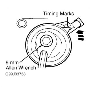

how do you change a timing belt in a 2001 escort zx2

2.Install NEW exhaust sprocket "O" ring. Install exhaust sprocket. Ensure tab on sprocket engages hole in oil control bushing. Loosely install sprocket bolt. Loosely install timing belt tensioner. Install timing belt. See Fig. 4 .
http://www.2carpros.com/forum/automotive_pictures/99387_Graphic4_6.jpg
Engage timing belt tensioner tab into upper timing cover backplate. Using 6-mm Allen wrench, adjust timing belt tensioner until marks are aligned. See Fig. 5 .
http://www.2carpros.com/forum/automotive_pictures/99387_Graphic5_2.jpg
Tighten bolt to 17-20 ft. lbs. (22-28 N.m).
