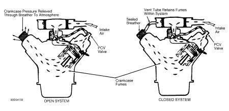

Yes it could be that, or maybe a clogged catalytic converter....Compression test of the engine will show low compression, ressure test of exhaust will show clogged cat! Also could be clogged PCV at least for the extra oil up top! check it...
https://images.2carpros.com/forum/automotive_pictures/62217_PCV_3.jpg
