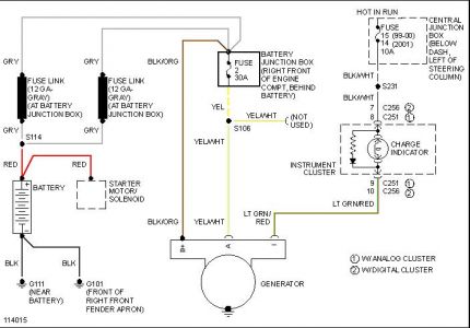

I have replaced the alt. And battery and it still is not charging

Check all the fuses and test the wiring for short and open-see electrical wiring diagram below:
