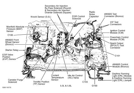

Where is the ECM unit located on a 1995 ford bronco

Powertrain Control Module (PCM)....On left side of firewall, left of main harness connectors.
