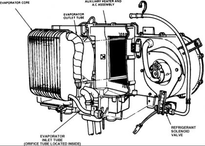

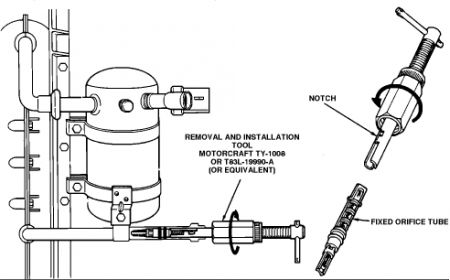

Where is the Orifice Tube on this vehicle?
Thursday, August 5th, 2010 AT 6:05 PM
MECHANIC
75,992 POSTS
Locations-see below:
The A/C evaporator core orifice is located in the A/C evaporator core inlet tube.
Fig. 5 Fixed orifice tube
Front Evaporator Core
Fig. 19 Auxiliary evaporator core
Rear Evaporator Core
