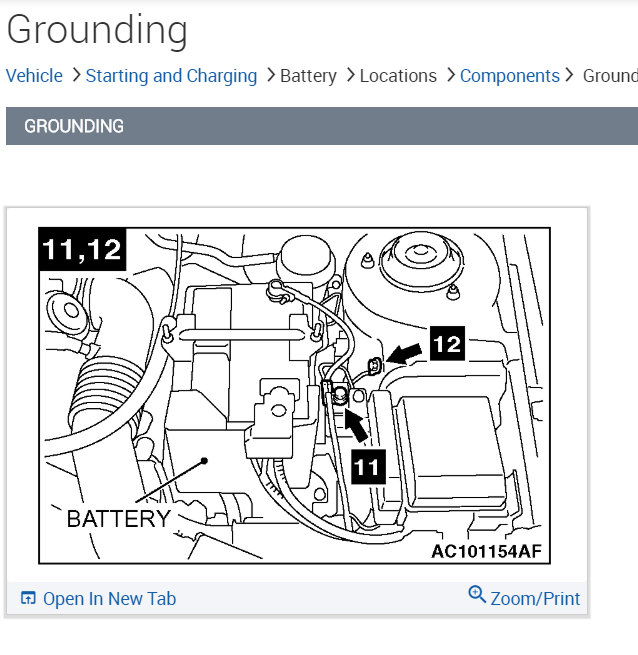

Where do I bolt down the negative battery ground on a 2004 dodge stratus. The cable comes from the battery to a junction where another cable runs towards the tranny. Where do I ground it?

The negative cable runs up to the front top of the left strut tower. It bolts on right between the two front strut mounting bolts. This guide will help walk you through the steps with diagrams below for your car.

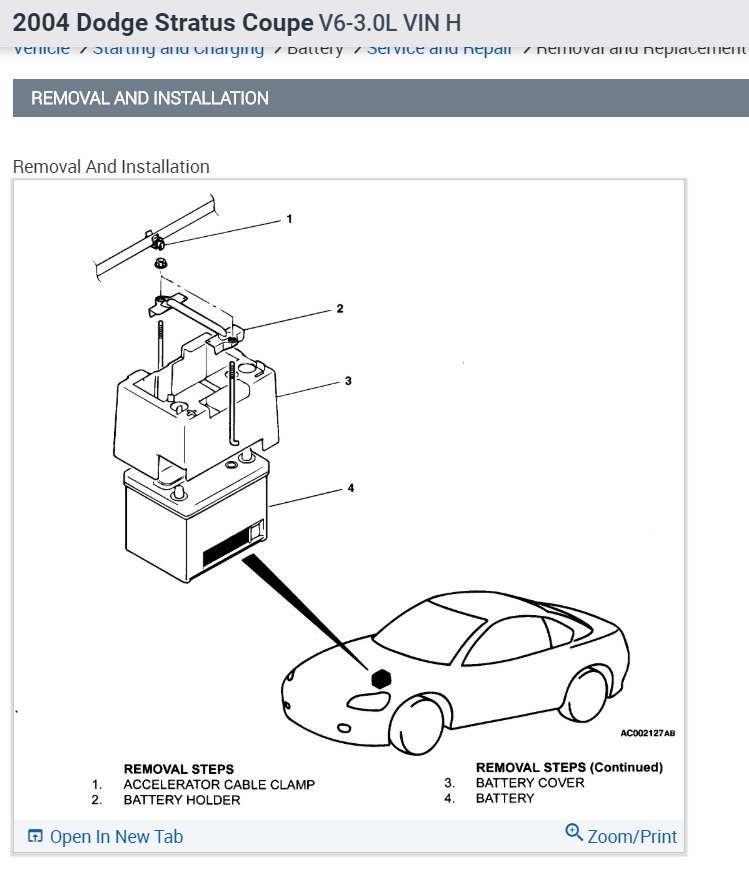

Where is the Battery in a stratus?
Saturday, November 23rd, 2019 AT 3:39 PM (Merged)
OBXAUTOMEDIC
  • 3,711 POSTS
Look in front of the drivers wheel.

Cannot locate, how do I get to it?

Where is the battery located on the dodge stratus
  • 75,992 POSTS
The battery is in the driver's front fender in front of the wheel. It is directly below where the (+) and (-) terminals are in your engine bay. You will need to remove the wheel and the wheel cover to access it.

Im trying to change my battery but I can not see were my battery is. How do I change my battery in a v6 engine 2000 dodge statis?
Saturday, November 23rd, 2019 AT 3:40 PM (Merged)
CARADIODOC
  • 33,743 POSTS
Turn the wheels to the right. The battery sits in front of the left front tire. Remove the plastic shield to get to it.

Where is my cars battery?
Saturday, November 23rd, 2019 AT 3:41 PM (Merged)
  • 75,992 POSTS
The battery is located by the driver's front wheel. You have to turn the wheel all the way in to access the panel to remove the battery.
