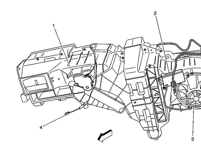

check for proper tstat install. then check the actuators in your heater i'll send a generic pic along

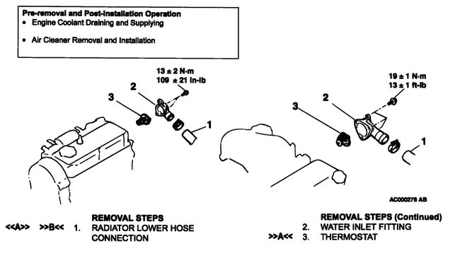

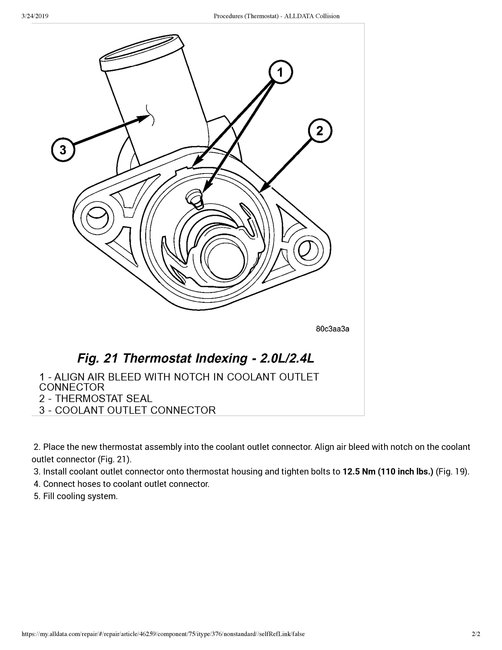

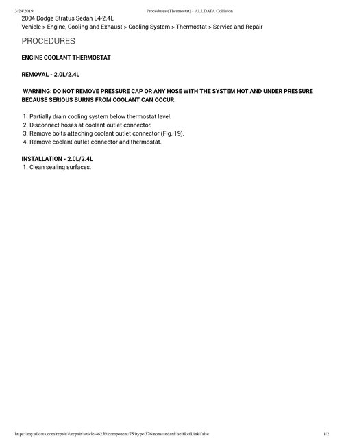

GAIL CRISP DALTON
How do you position the thermostat?
Oct 27, 2020 at 10:03 AM (Merged)
JOETECHPRO
  • CAR REPAIR CONTRIBUTOR
  • 705 POSTS
Hey GAIL CRISP DALTON,
Please see the instructions below on thermostat replacement for your vehicle.
You should be able to see orientation from the picture in the instructions.
Any further questions do not hesitate to ask.
Regards, Joe
ok, it wont show pictures but it is at the end of the upper hose to the cylinder head. easy job.
REMOVAL
WARNING: DO NOT REMOVE PRESSURE CAP WITH THE SYSTEM HOT AND UNDER PRESSURE BECAUSE SERIOUS BURNS FROM COOLANT CAN OCCUR.
Drain cooling system to the thermostat level or below.
Disconnect hoses at coolant outlet connector.
Zoom Sized for Print
Remove bolts attaching coolant outlet connector.
Remove coolant outlet connector and thermostat.
INSTALLATION
Clean sealing surfaces.
Place the new thermostat assembly into the coolant outlet connector. Align air bleed with notch on the coolant outlet connector.
Install coolant outlet connector onto thermostat housing and tighten bolts to 12.5 Nm (110 inch lbs.) .
Connect hoses to coolant outlet connector.
Fill cooling system.
Oct 27, 2020 at 10:04 AM (Merged)
