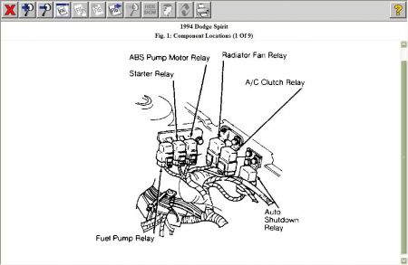

I have no fuel pressure. Can you tell me if it has a fuse or a relay for the fuel pumpand where it or they might be located?

Inspect and test the fuel pump relay and ASD relay-there's no fuel pump fuse-
