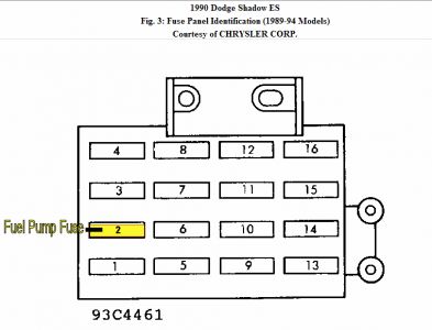

I can't find the fuel pump relay. If you could tell me where it is located that would be wonderful.
Thank you
Candy
Thursday, July 17th, 2008 AT 3:07 PM
OBXAUTOMEDIC
MECHANIC
3,711 POSTS
Your fuel pump is fused not relayed.... Looking at your fuse block the #2 socket is the fuel pump it's a 20amp Yellow fuse......
