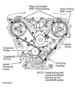

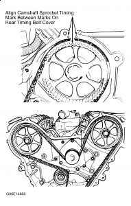

2004 Dodge Intrepid TIMING MARKS
JUICE13
MEMBER
2004 DODGE INTREPID
Engine Mechanical problem
2004 Dodge Intrepid 6 cyl Two Wheel Drive Automatic
how to line up the chain with the timing marks?
Saturday, August 15th, 2009 AT 12:01 AM
BMRFIXIT
MECHANIC
19,053 POSTS
SPONSORED LINKS
Saturday, August 15th, 2009 AT 6:52 AM
