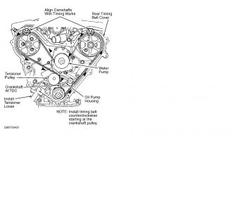

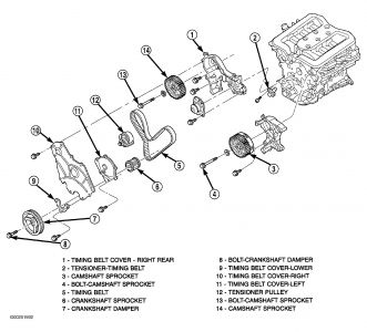

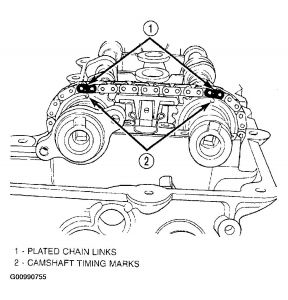

I need to know exactly how to align the marks on the timing chain with the cam shaft sprokets, and the crank shaft sproket.

O2 dodge intr 3.2L and 3.5 L

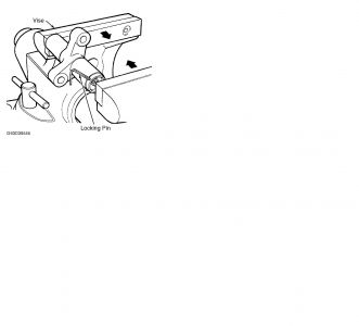

2.7L
