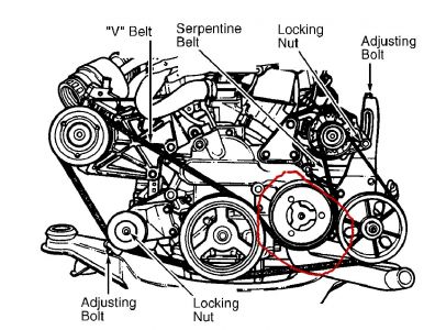

Can pull off the belt and try to turn the water pump by hand.
https://images.2carpros.com/forum/automotive_pictures/30961_wp_1.jpg
To verify the pump is frozen.

r6rainz9,
Which engine is in that Intrepid? Mine has the 3.5 in it, and the pump is driven by the timing belt. If that pump locks up, the timing belt goes away and the engine doesn;t run.
I'd say have your son check the oil etc as the previous responder indicated. That will give you a pretty good indication of what's going on.
