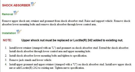

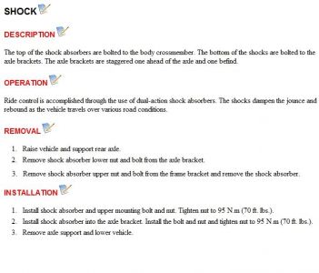

How to remove and replace front and rear shocks
Friday, March 12th, 2010 AT 1:59 PM
BLUELIGHTNIN6
MECHANIC
16,542 POSTS
FRONT
REAR
