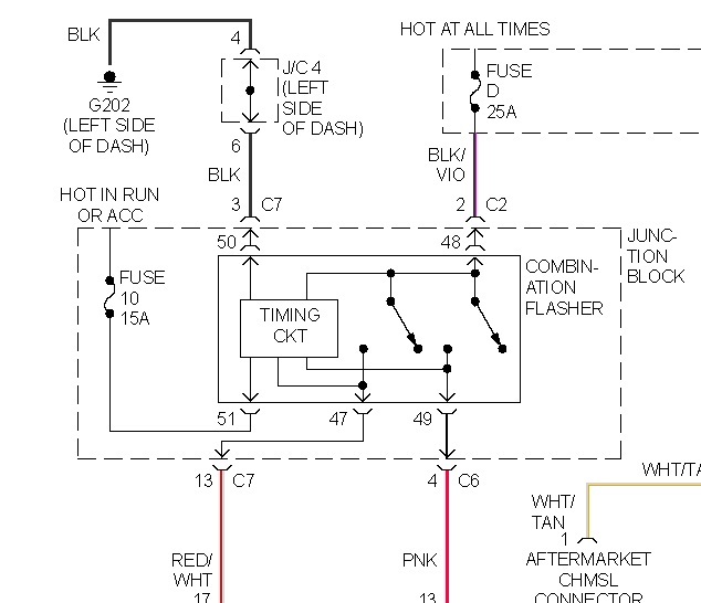

I have a 99 dodge dakota sport. Recently my turn signals began to malfunction. First they would only blink a few times than stop. Now they have stopped working all together. I replaced my front headlight bulb as I thought that might have something to do with it. Every once and awhile they will work (usually only two or three blinks before cutting out again) but most the time they arnt working at all. I had this problem a few months ago, but it fixed itself. MY four ways do work.

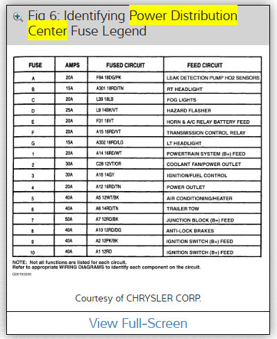

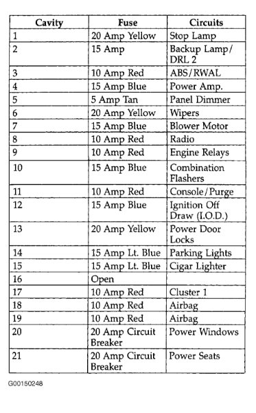

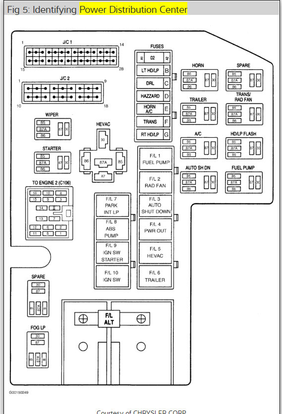

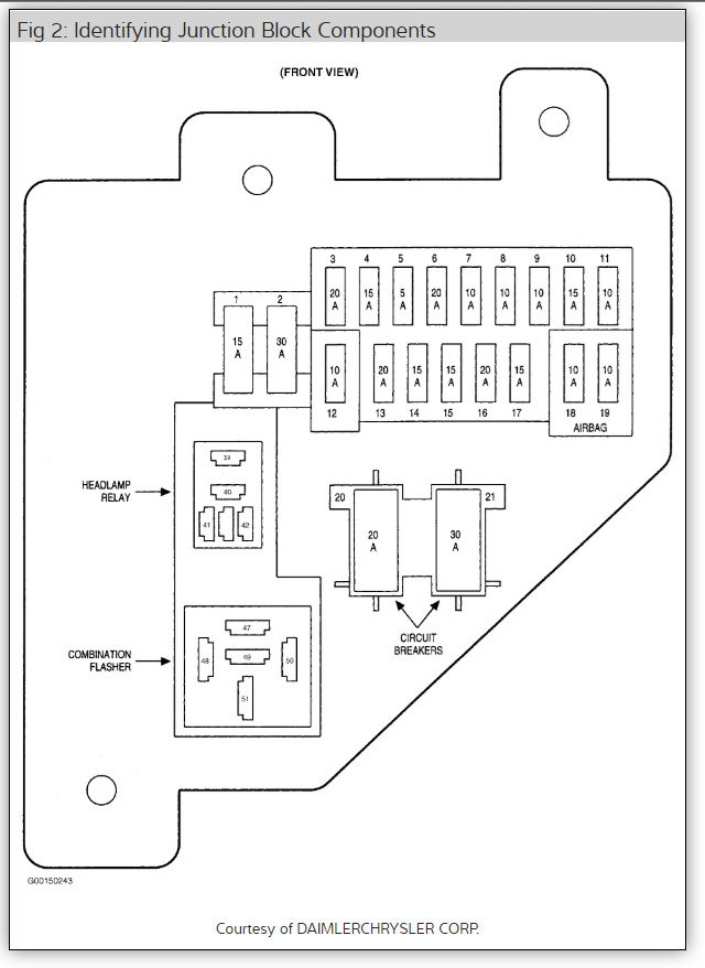

It sounds like the combination flasher is out here is the location of the flasher and the blinker wiring diagrams so you can see how the system works.
Check out the fuse panel and relay locations (Below). Please let us know if you need anything else to get the problem fixed.
Cheers

Suspect the flasher unit. It's no longer the common sense, reliable three-dollar flasher. It's now a very expensive electronic module. Sorry I can't remember exactly where it's located but if the hazard flashers still work, you can follow the clicking noise to the unit. On vehicles where that flasher is plugged in and sitting sideways, its weight often pulls it partially out of the socket. Simply reseating it will get it working again.

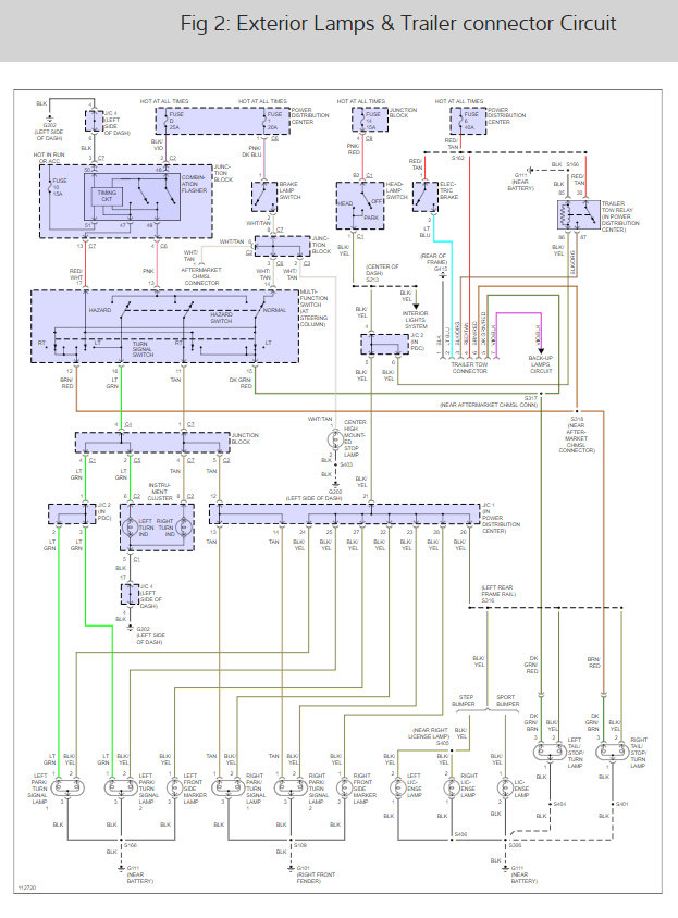

JDL
  • 16,098 POSTS
Did you use a voltage tester at the applicable fuse/s? The hazzard fuse circuit, should be hot all the time. The one for your turn signal should go hot when you turn on the key. Note diagram below.
If that checks out, probably the multifunction switch, but, If you want to get under the dash and check wiring circuits for voltage, we can do that, also.

Left turn signal will not flash with the headlights on
Friday, December 18th, 2020 AT 8:39 AM (Merged)
CARADIODOC
  • 33,741 POSTS
What you should find is the problem occurs with just the tail lights turned on. That is due to a bad ground wire. You can prove this by turning on just the tail / running lights, then the left signal, then remove the signal bulb from the other side. If the left bulb goes out when the right one is removed, the left one has a break in the ground wire. With the running lights off, current goes through the left signal bulb, can't find a path to ground to complete the circuit so it looks for an alternate path. That is to double-back through the tail light filament in the same bulb, then go over to the tail light on the other side, through it, then to ground. Since three filaments are in the circuit now, there's three times the resistance, which means one third the normal current flow, and that's not enough current to heat up the heating element inside the flasher assembly, so it either flashes real slowly or not at all.
To know if the problem is in front or in back, if the bad ground is for a front bulb, the turn indicator on the dash will light up dimly too.

HUIE LAMB
Thanks Guys. This pointed me in the right direction. I found a short in my trailer plug in.
