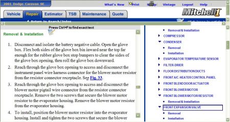

The a/c and heater only blows out on high speed. I was told by a Dodge car repair specialist that my blower motor problem was likely due to a bad resistor. I was just wondering if this was a labor intensive or expensive repair. I would love to try to do this repair myself and save some money, but if it is best left to the experts I will not try it.

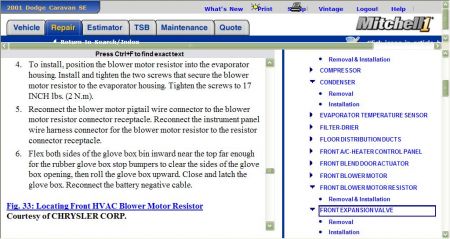

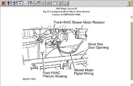

There you go and Good Luck The blower motor resistor is located on the HVAC assembly, behind glove box also see below for R/I
