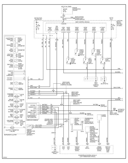

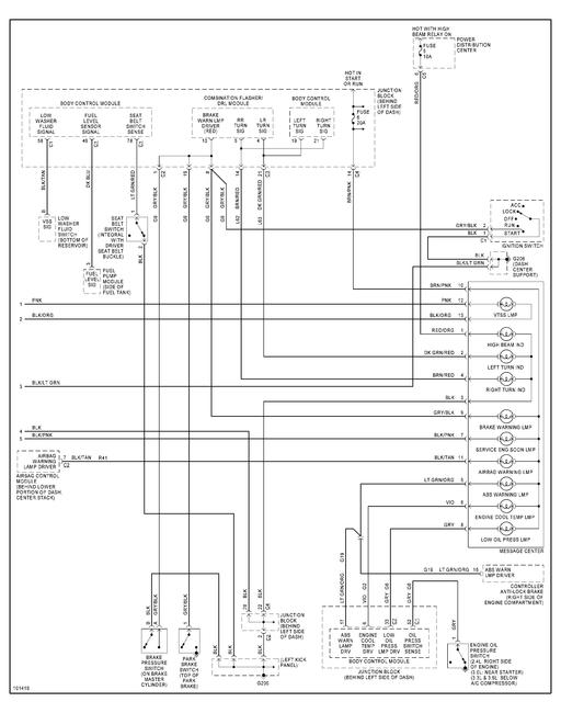

Thank you much but im Trying to fix this one. It worked fine until I tried fixing the bad solder. Short on money just need a diagram to figure out what I did wrong or still need to do.
Aug 29, 2019 at 2:12 PM (Merged)
CJ MEDEVAC
  • CAR REPAIR CONTRIBUTOR
  • 11,004 POSTS
I fear you may have heat damaged some sorta cyber device in it
There were 2 other choices on "caravan" in "mitchell i"......not to mention the grand caravan stuff..........engine size did not enter in with my search
................i picked plain jane "caravan" when i grabbed you these diagrams
This is "instruments 1 of 2" and also "instruments 2 of 2"
Good luck, lemme know how it goes
The medic

Thank you for the diagram it should help. Any place I could find a picture of the instrument cluster board ? (Actual picture. ) that would be most helpful. Thank you again.
