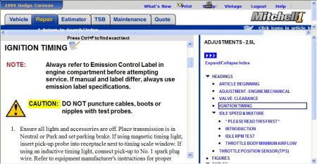

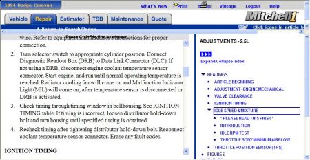

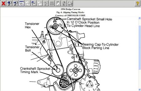

In the process of changing the water pump too many parts were taken off and the motor timing belt is off. Can you please help me get my van back working? I need to know what time everything needs to be on, can u please assist asap.

Put engine no.1 piston on its compression stroke/TDC and align everything as you see in the pic
https://images.2carpros.com/forum/automotive_pictures/12900_timimg_mark_caravan_1.jpg
