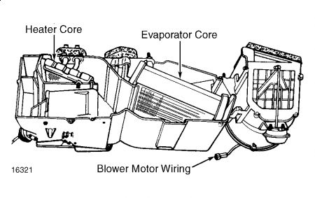

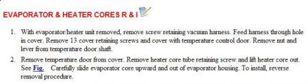

1989 Dodge Caravan Heater core replacement
HICKEYJ
MEMBER
1989 DODGE CARAVAN
Engine Cooling problem
1989 Dodge Caravan 6 cyl Front Wheel Drive Automatic
How to replace heater core
Tuesday, March 2nd, 2010 AT 4:29 PM
2 Replies
BLUELIGHTNIN6
MECHANIC
16,542 POSTS
SPONSORED LINKS
Tuesday, March 2nd, 2010 AT 4:33 PM
