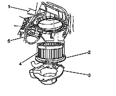

When I start my truck, there is a clicking noise that is coming from my blower motor. It will not push air out of the face vents, but the defrost and floor air comes out fine. I think that it might be one of those febreeze air fresheners that you put in your vent that fell through and is now stuck in the blower. Would I have to take out the entire dash to get to this problem? Someone please help. I need my air fixed!

It's pretty simple, remove the panel on the right side under the glove compartment. Remove the storage compartment door. Pull of connector to blower motor and unscrew. .. I attached a picture for you also.
If you have any more questions, let me know
